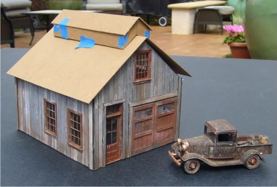

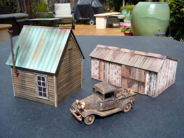

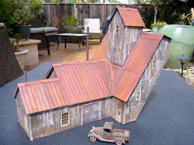

I have made a little progress on my mine scene area, including about 90% complete on the main structure and various out buildings. Attached are some recent photos of the basic structures. I am going to call the mine "A. Frendly Mine" and then have a bunch of signs stating "keep out", "this means you", "no trespassing", "trespassers will be shot on sight".
