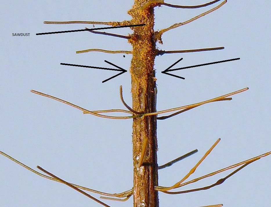

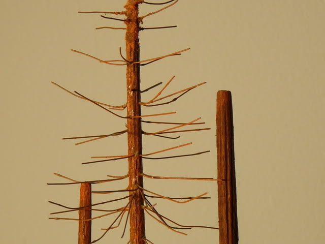

here are some pictures of the tree so far:
The frame in all its glory:
the transition from trunk to the wiredframe:

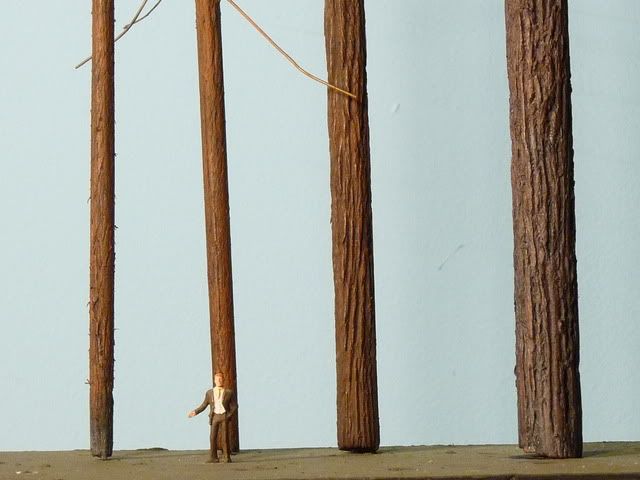

Some samples of trunks...the right one is made of balsa the other ones are/were just some small pieces of wood( round/cylinder)
As you can see( hopefuly) the left trunk is colored the way MIke wrote about..so NOT with the Latexwallpaint as I used to do in the beginning of coloring them....The engraving is still there and looks more natural.
This picture shows the branches I made by drilling 1 mm holes and stick some=3 wires(0,4diam mm) in it. Attached them with a drop of superglue.I also used some 1 mm diam.( floristic)wire branches, specialy in the lower parts of the trunk...

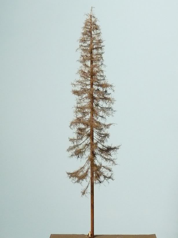

total view of the tree:
Have to shape the fibers on the branches here.and there with a scissors and sometimes a tweezer or brush dipped in terpintin to loose the "wrongplaced"fibers..
Hope to finish the tree tomorrow!
