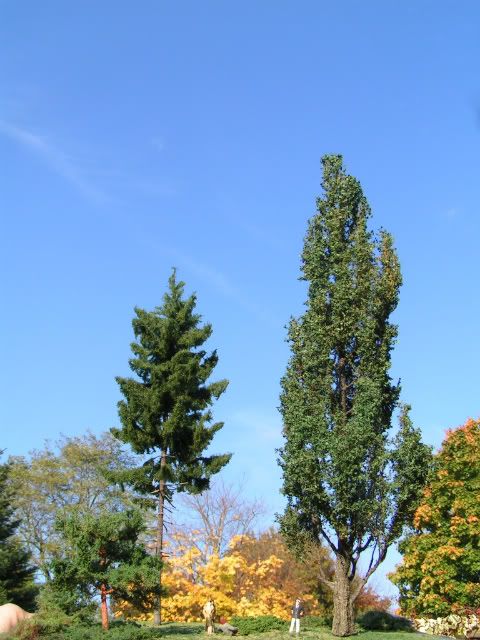

Those trees are better than life! You set new standards... Inspiring and scary!
17652 Posts
Posted - 09/16/2008 :  4:43:16 PM  Show Profile  Reply with Quote
Glad to see you can't.
The trees in the last shots are great too.

Bbags
13325 Posts
Posted - 09/18/2008 :  09:57:24 AM  Show Profile  Reply with Quote
Jos,
Again, your trees are as good as they get.
I like how you modeled the trees in the following picture.
I live in Georgia, the state not the country and here is a southern pine that shows that lower branches tend to die off and turn brown.
You have captured that look even better than on a real tree.
Looking forward to you getting your computer back and sharing your techniques.
John Bagley
