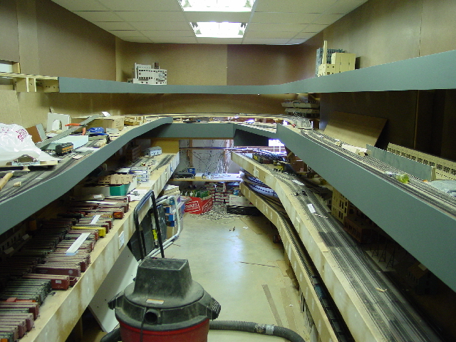

Hi Rick,
Your fascia is looking very nice. I like the combination of the fascia and valance. It gives it a very nice finished look.
Did you glue your fascia to the decking? I only ask because I glued and screwed mine. When done, I removed most of the screws and left others countersunk. I then filled the holes and seams with patching spackle, sanded it, sealed it and then a finish topcoat. Here is a photo that shows the upper fascias painted and the lower ready for sealing. Thought it may interest you since you are working on your's.
Please excuse the mess!![:-boggled]

Morning, Andy....that's some really impressive fascia work! And THREE levels on the right side? How long is your mainline?

Hi Rick,
I feel your pain in several areas. I too have a habit of deciding to make changes once I've built something. I've ripped up a fair amount of track and framework including sections of fascia. But I still like to glue things such as the fascia since it makes it much more sturdy (in my mind!)
I also wanted the fascia to be painted a color that would not attact the eye. It is actually darker than it shows in the photo. I got a color as close as possible to Great Northern Empire Builder Green. It has a very slight touch of gray and I'm happy with the look. This is even more important when it comes to a multi-deck layout.
I painted most of my floor with the proper paint with a primer sealer under it but the paint has been chipping and coming up in chunks. I do have commercial carpet squares that were given to me, enough I believe for the whole visible floor.
The carpet is blue with flecks of gray in it. My wife is making black fabric skirting for the layout and I think the three colors, fascia/skirting/carpet are going to work out nicely. We will see!!
The lowest deck on the right in the photo is actually north staging. Not much fun to use as the body gets older![:-boggled] But it works good enough for what I need.
The layout will have three decks and the mainline will be close to 1000' long when done. I plan to have 50 staging tracks, 25 at each end of the railroad.
Should keep me going till the end, my end that is!![:-eyebrows]
