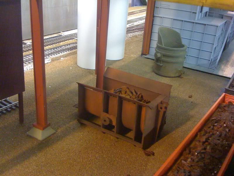

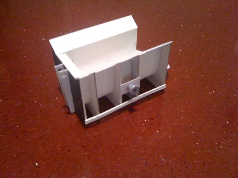

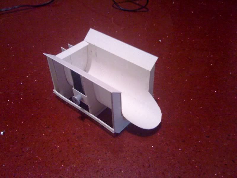

This morning's futzing:
For some time now I've need to scratchbuild a scrap box for the Maclay Street BOF; after staring at the one in Dean Freytag's "Cyclopedia of Industrial Modeling" for some time now, I decided to continue futzing with cardboard as a modeling medium.....here's the results:
A scrap box is used to charge the BOF vessel with pre-sorted, dry scrap...and looks a lot like a big dumpster, albeit with a "scooped" opening to make loading easier. The vertical braces shown were cut from standard illustration (mat) board that's about .050 thick using a traced pattern from Dean's book. The sides and rounded bottom are made from one piece of 3 ply Strathmore; the other parts various thicknesses of Strathmore and light card from my cast-offs pile. The rear brace includes a lifting eye made using a paper punch; the lifting trunnions on the sides are the bottom halves of Walther's roof vents:
One thing that makes fabricating with cardboard easy is contact cement, which grips enough to keep things in place, yet flexible to allow some adjustment. In this case, I'm using a clear product called "Welder" that I picked up at Lowes.

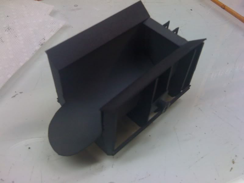

After a quick spritzing with Rustoleum Dark Gray primer:

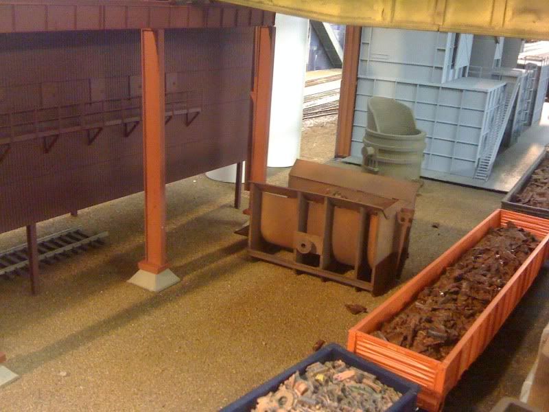

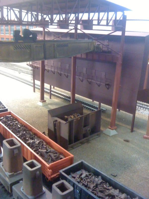

Twenty minutes later, I gave everything a dusting of chalks in various rust hues, loaded in some appropriately weathered scrap, then placed it in the BOF scrap shed. Later, after I've finally figured out how to design it, the box will be mounted on a wheeled dolly that will move on an elevated trestle into the BOF:
This was my first "non structure" model using cardboard and although certainly NOT contest quality by any means, find myself pleased with what the medium has to offer. Easy to cut, easy on the wallet, easy to purchase, easy to curve and bend, and easy to glue, cardboard's one downside is probably moisture, which I hope that the paint will provide some degree of protection from. If you look close, I attempted to fabricate my own "c' channel on the lower sides using the material and at a one foot distance, think it can be pulled off. From here I want to try fabricating my own "I" and "H" beams to see how they'll come out.
