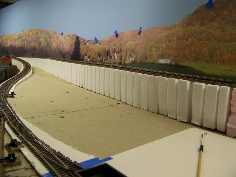

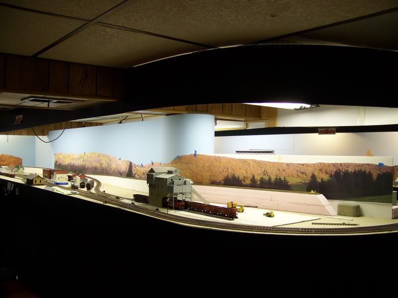

Having spent the better part of the afternoon trimming, fussing, cussing, and running out for Scotch tape (arrggghhh!), I finally put most of the pre-printed scenes together, then began taping them up in different spots to start getting the effect. As always, here on the "Seven Miles of Sheer Operational Terror", nothing is ever really "permanent", hence the judicious use of obnoxious blue masking tape (another thing I ran out of unexpectantly). Here's Lucknow again with some additional fiddling and another scene:
A closer view reveals a HUGE evergreen sticking up unappropriately....which will eventually be covered by a foreground hill mass:

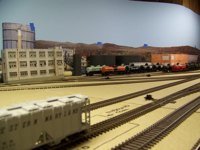

Commonwealth got a long section to stare at:
And finally, a low level shot of Front Street in Lucknow, looking "north" with the autumn hillside in the distance:

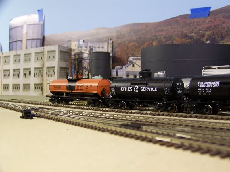

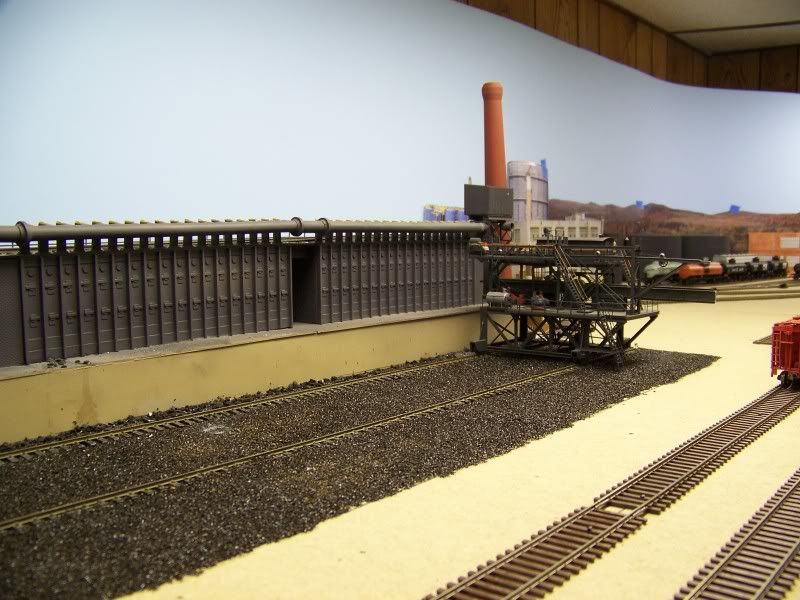

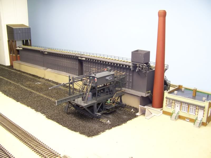

First up is the Commonwealth Coke and Chemical area. Mark F convinced me to deep six the refinery portion and instead install two more sidings to make the work there a bit more "interesting" (ie: frustrating). I finally got around to installing the coke pusher track and spreading a little ground cover around it:

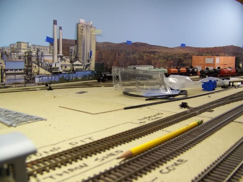

Here's the area that will have an additional two sidings installed in the foreground; I figure one for ammonium sulphate loading and another for a warehouse/storehouse. the building in the background is one of the Radical Flats background/low relief buildings; the storage tanks were made by sawing a Walther's kit in half and placing them against he backdrop:

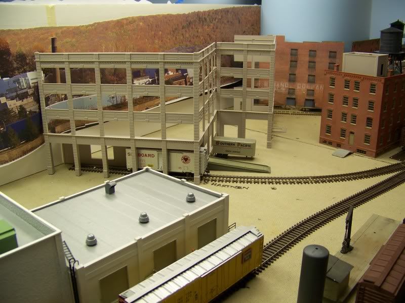

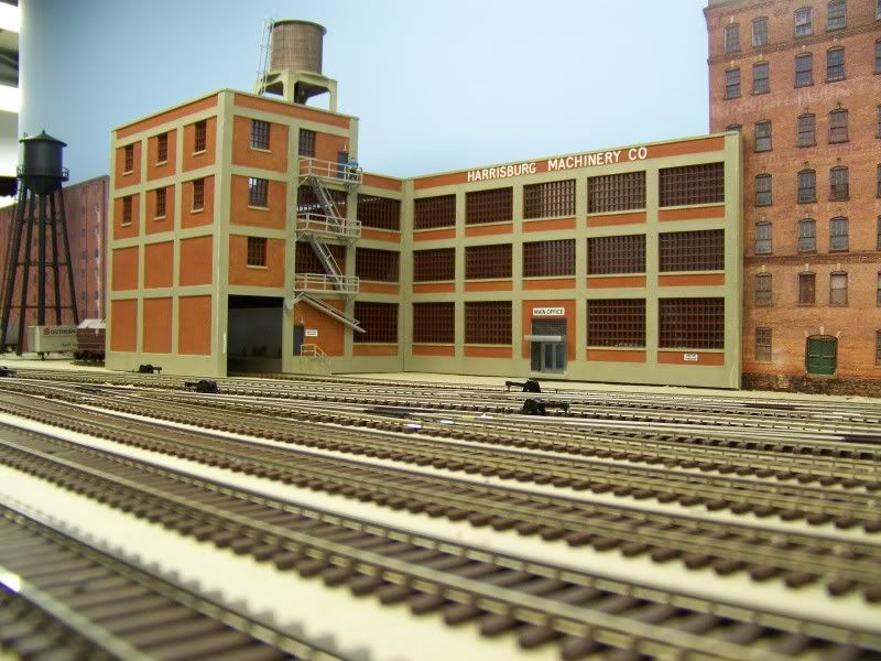

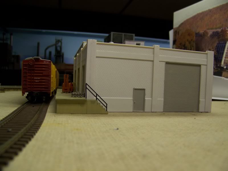

Over in North Harrisburg, the future Hoover Furniture or Mock & Hartman building (Walther's Furniture Factory) has been semi-assembled and placed in location to undergo the usual "ponder and procrastination" phase of my modeling. As you can see, it's been semi-bashed to fit the location as well as tighten things up in this urbanized setting:

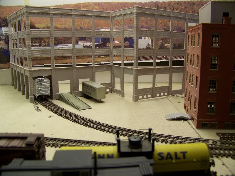

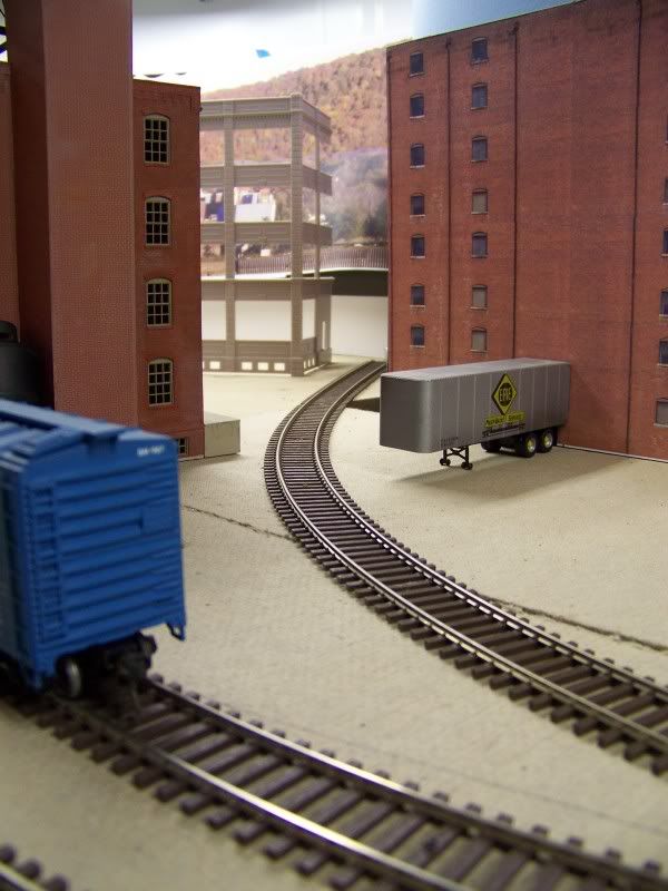

The former Mock and Hartman siding has been re-arranged to better suit the topography; this will be asomething of a flange squealer to switch:

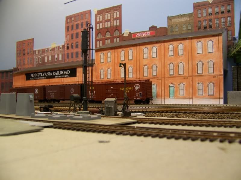

Lastly, a ground level shot of Maclay Street...with the new backdrop buildings taped in place to judge their suitability.
I recently read an article in MR where the author noted he attaches his photo backdrops with double-sided tape, an enticing idea to consider, especially since I'm not looking forward to smearing rubber cement onto six and eight foot pieces of paper, then trying to accurately place them on the backdrop. Spray cement is a definite "no-no" around here....Mrs. Harsco's lawyer would be on the phone before I could finish spraying!

Rick, the flats at Maclay Street look fantastic! Don't worry, you've already proven that having the ability to move things around and 'tweak' things is beneficial. Seems each time we do that, we find a combination that looks even better.

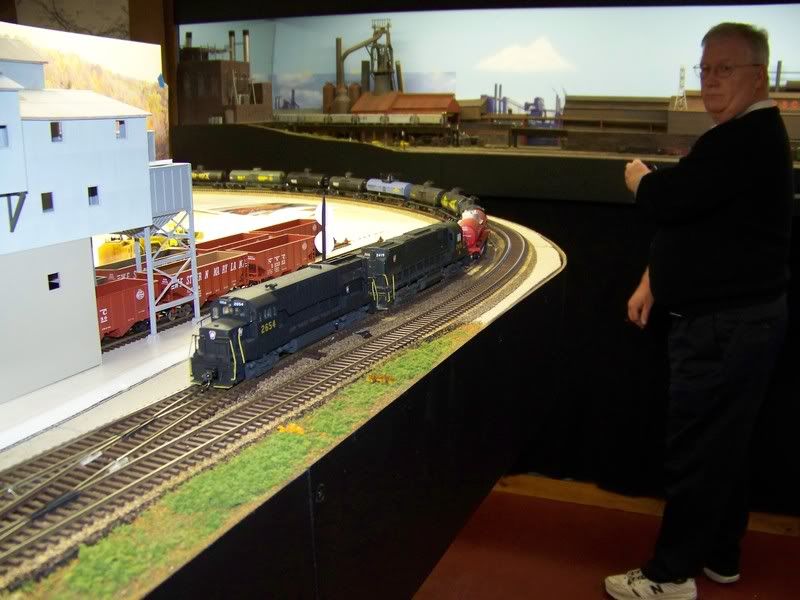

Well, we managed to gather up the troops last evening and continued the process of "tweaking" the operational schedule, this time finding out that sometimes less can be more. Being a crew member short, we figured we'd have to annul some movements in order to keep chaos at bay, but curiously enough only one train was cancelled and everything ran fairly smoothly. By dividing up the work a little more, as well as assigning dual responsibilties, Mark F functioned as dispatcher and was able to run a train or two, while Diamond Bill handled a local and a through freight in between shuttling cars at Division Street - a welcome break from just sitting at a desk or waiting around for the next local or through freight. With Steam holding down the critical Herr Street Yard job and me further refining the movements needed at the Basic Oxygen Furnace at Maclay Street, John R, Joe H, and PJ handled the road jobs in their usual excellent fashion. Here's a few shots of the action:

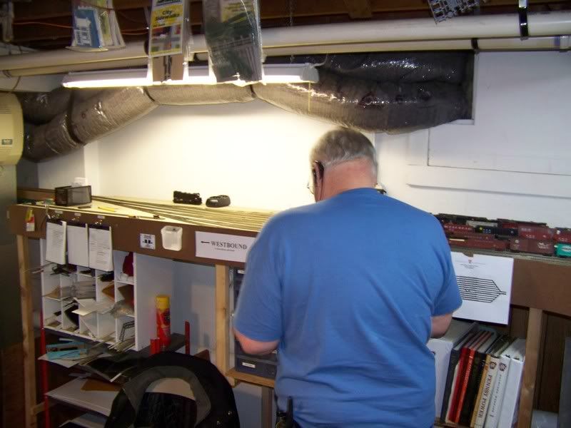

PJ picking up his train in staging:
Steam getting his work space organized before the wheels begin to turn:

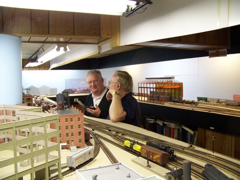

Joe H and Diamond Bill engaging in favorite pastime: breaking the dispatcher's chops:

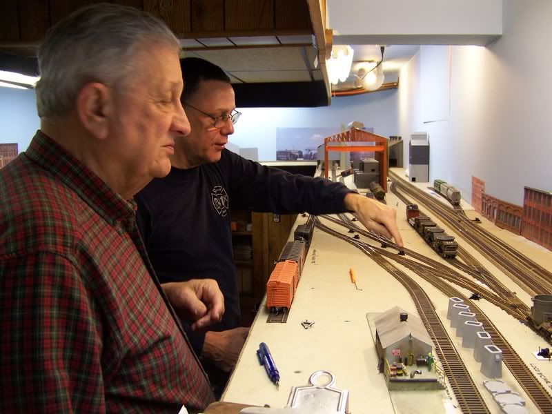

John R and I swapping slag cars at Maclay Street. We managed to add in another operational layer last evening and ship molten iron and steel to our on-line customers, which required a little bit of thought and pre-planning to pull it off. Cooperation between the Herr Street operator (Steam) and the Maclay Street foreman (me) made what we thought would be a nightmare really not a bad experience at all, a testament to the crew's coping skills:

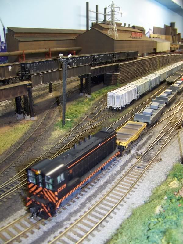

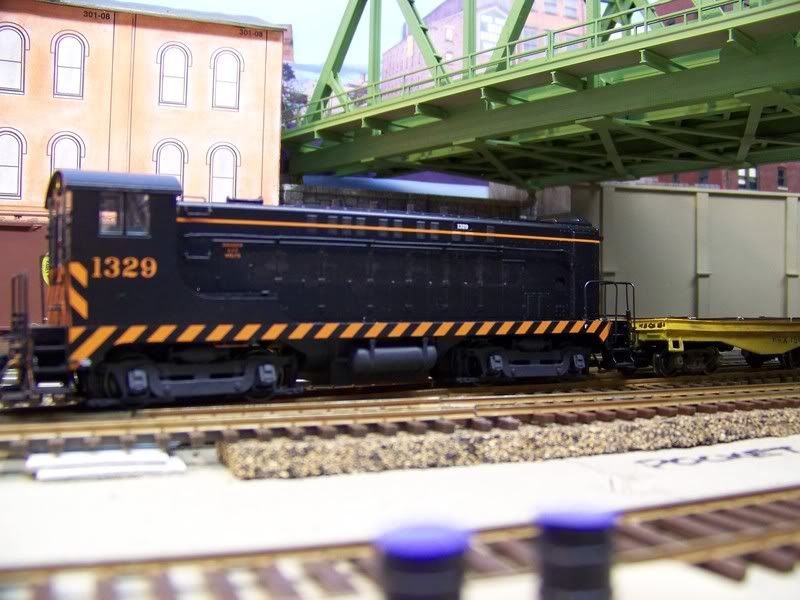

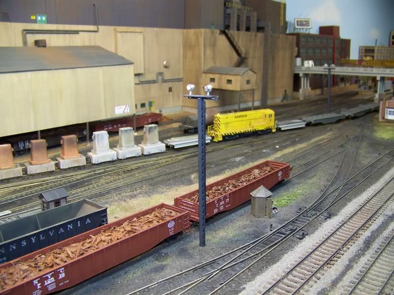

Using trackage rights over the PRR, the HARSCO Maclay Street switcher 1329 shuttles just-pulled steel slabs the short distance from Herr Street to the soaking pits at Maclay:

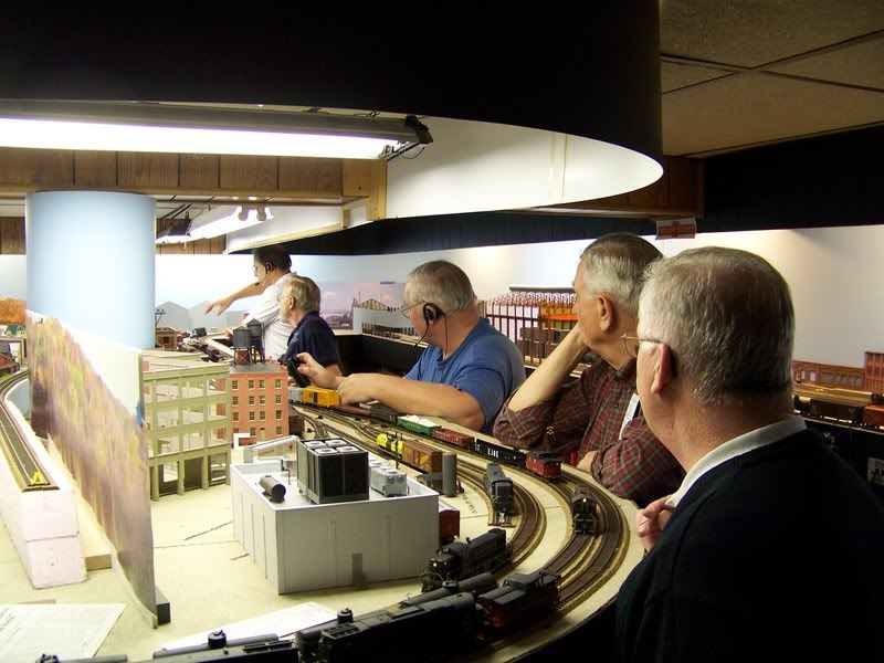

An illustration of why wide aisles are a necessity; the gang gathering around Division Street to swap cars and adminster a few verbal slaps to the poor dispatcher....

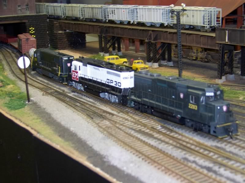

After exchanging cars at Division Street, through freight WPD-2 (Enola to Potomac Yard) blasts out the tunnel at the west end of Herr on it's way to the C&PD and points south:

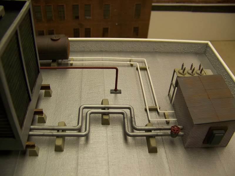

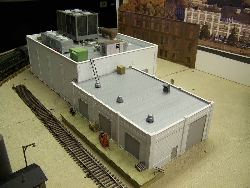

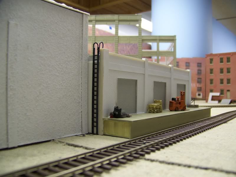

I've neglected updating the Vernon Cold Storage project I started some time ago and wanted to post a few pictures of the still semi-finished building:
Since the building itself is rather plain, I wanted to make certain that the rooftop area - with all it's piping, condensors, coolers, and associated equipment, appeared appropriately "busy" enough even though I know absoultely nothing about HVAC installations. Using a combination of scratchbuilding, kitbashing, and commercial parts, here's a overal shot of the building's roof area:
The main portion - the actual storage area - is where the heavier items are located: cooling towers, pumps, electrical panels, and piping. The towers were scratchbuilt using O scale clapboard siding with framing; the piping is Walthers', along with the small equipment shed. Ventilators and smaller condensors are Walther's kits as well. The "detailing" will continue as I notice things that should be added, such as ladders and catwalks on the cooling towers as well as electrical conduits, floodlights, etc.
Vernon Cold Storage functions as a short and long term warehouse for perishable foods as well as operating a small packaging operation for area farmers. A cold storage facility can be a good generator of traffic, taking in vegetables for storage until released for local distribution via truck or as a holding area for local goods being shipped out. The smaller portion of the building functions as an office and loading/unloading/packaging area.
In keeping with my modeling habits, I'll continually go back and change and add things on the building as I gather more information or ideas. One thing I'm pondering now is the best way to letter it: decals, dry transfers, or a signboard with printed lettering....I may try the easiest way first, then move on if unsatisfied.

Good looking rooftop equipment, Rick.
If I had the walls laying flat on my bench, I would probably go with dry transfers. With the walls erected, I think I'd go with a sign board.

I'm in agreement with your choice Bruce; never having had much luck with dry transfers, I tend to lean towards printed signboards or decals, which I don't think would work very well with the rough wall texture. Will have to start noodling around on the computer to come up with something appropriate.

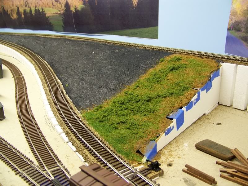

Odds and ends time: I mentioned not showing what Mark F and Steam have been up to; here's a shot of the first real, honest-to-goodness scenery being done on the layout, a hillside in Lucknow courtesy of Mark F:

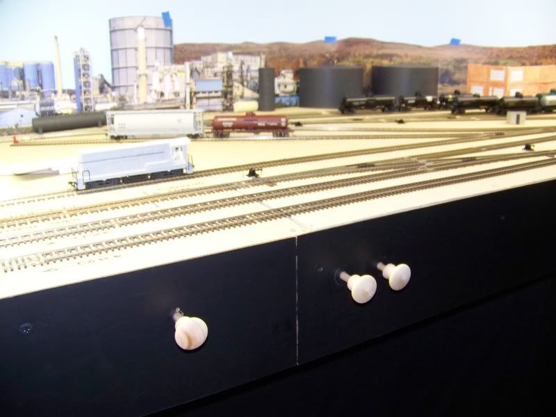

Steam "lent" me a Blue Point manual turnout control, then devised a convenient and simple method of controlling it remotely via a wood dowel that protrudes through the fascia. Here's the set up under the layout:
And what it looks like on the outside:
The Blue Points are very nice, offering a positive lock as well as additional electrical contacts for powering the frog or even signals. In this case, they eliminate the operators having to reach over a lot of benchwork and cars to throw a switch. The downside is minimal if you're proactive about cutting in a slot in the surface under the turnout beforehand. Unfortunately I have four or five turnouts in the Herr Street yard that need to be remotely controlled but are already buried under a lot of dirt and chalk....we've had some luck with the old Eschelman turnout links which (to the best of my knowledge) are no longer available. Hindsight being 20/20, I wish I had taken the time to cut the slots back then...on a shelf style layout, Steam's control linkage is easy and painless to install. One other possible drawback is the need to be 90 degrees to the layout edge - or close. Steam was able to bend the conneting wire attached to the end of the dowel to allow it to reliably activate a slightly offset turnout.

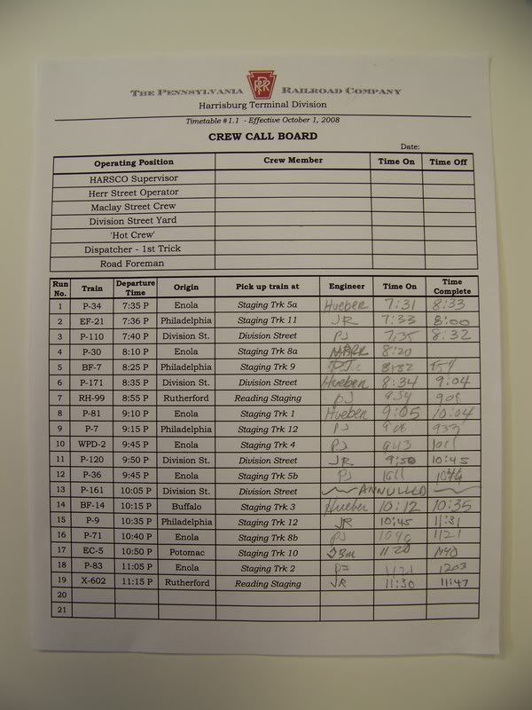

Lastly, an example of the operational paperwork created by Mark F; the first is the Crew Call sheet showing the scheduled train movements, crew, time on and time off:
