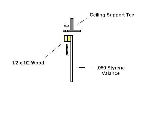

Rick, who is your plastic sheet vendor? It wouldn't happen to be Everything Plastic (formerly Arch Street Plastics) near the BF Bridge in Philly, would it? I'm also using .060 polystyrene for my backdrop, which I purchased there. I was just wondering if there's someplace not across the Delaware "Ocean" that carries it.
Also, care to post a little bit of detail about your lighting and valence constrcution?

Bruton...sorry I didn't answer sooner...and it was great meeting you yesterday. I bout 4 x 8 sheets of .060 styrene from a plastics distributor in Mount Laurel; the name escapes me at the moment but I'll try to find out and post it. There is a minimum charge of $50.00 as memory serves.
Since I have a suspended ceiling, the valance was constructed to hang off the sheet metal supporting system. Basically, I scored and snapped the styrene to the desired width, then attached a piece of 1/2 x 1/2 wood trim (Home Depot or Lowes) to the top edge. Then, holding it in position,marked where it crossed the sheet metal supports, drilled a hole through the wood and support, and attached it with a small nut and bolt. Here's an explanatory (I hope) diagram:

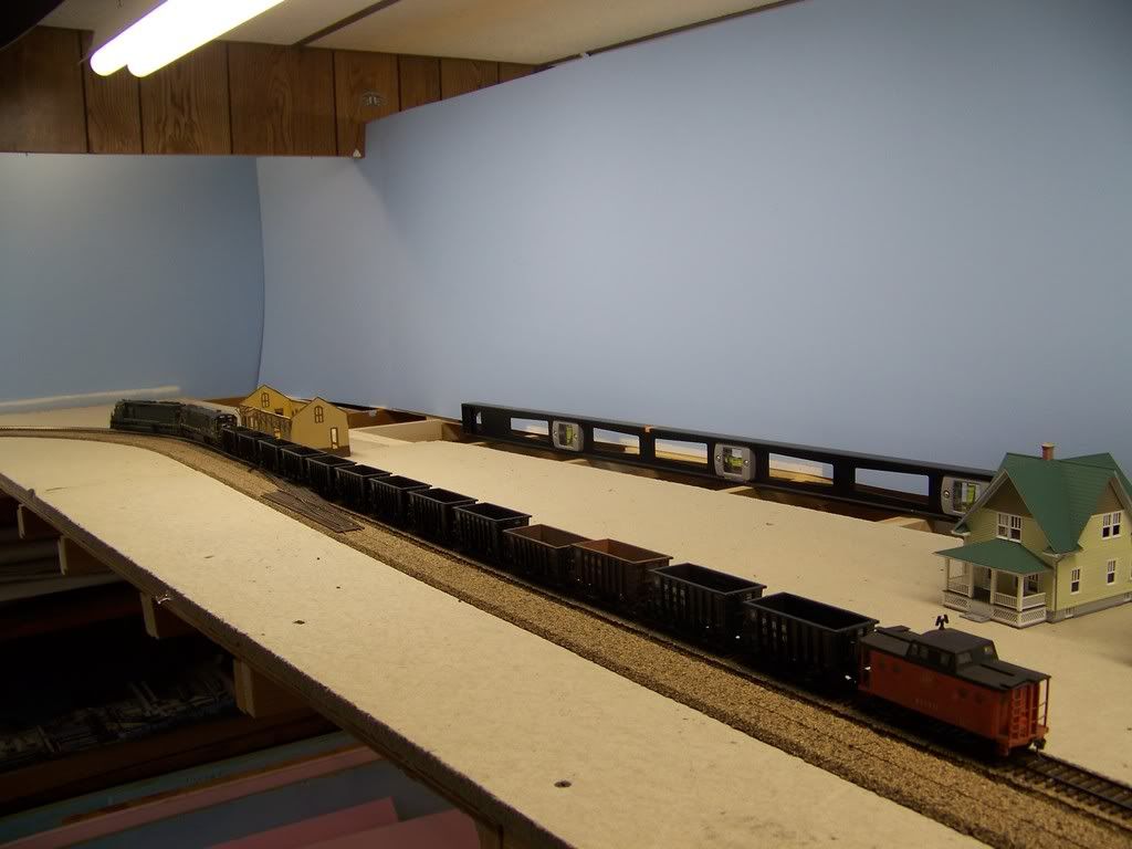

One of the cheif reasons it's took me so long to get this far is due to a very bad habit of interrupting my work efforts and indulging in a little futuristic fantasy....having accumulated a few PRR ore jennies, I couldn't resist an urge to pose them:
Philly to Pittsburgh Ore Movement Past Herr Street Yard:

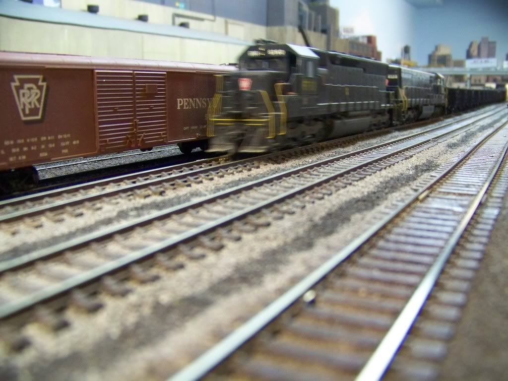

And passing through Lucknow:
