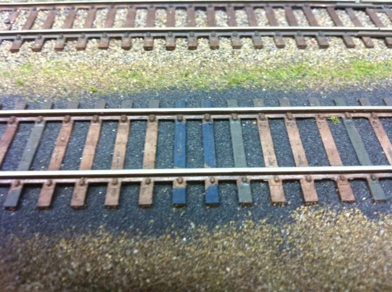

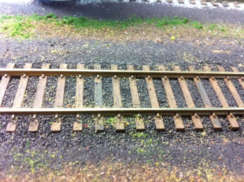

George, the only drawback I can see is the size of the granules; compared to WS or other brands, it's going to look much smaller, which may or may not be a problem for you. To better illustrate the differences, here's picture of a grout-only track in Division:
And here's a WS Cinder and black grout combination I'm experimenting with in Market Street:
You can see the larger WS ballast between the rails and tie ends with the grout "fading out" towards the ground...
As far as which is better, it depends on your own tastes; personally, I like how the grout settles down nicely without sticking to the ties and spikes; a few swipes of a fluffy ballast brush and everything's in place...even better, it doesn't scatter around when you spray wetting agent on it either. If memory serves, a 2 lb carton of grout costs about four to five dollars.
Where I really think the grout shines from an appearance and ease of use perspective is in modeling asphalt roads; so far I've futzed with regular and lightweight spackle, plastic, and illustration board with a paper texture but can't beat the grout for how easy it is to apply. And, being a smaller granule, it provides a rough texture without being grossly over-sized.
The grout comes in an array of different colors, and part of the experimental process for me will be to try to find something close to weathered concrete for modeling streets...scribing in expansion joints might prove challenging since the wetting agent/white glue adhesive turns this stuff rock hard. Perhaps the solution might be to glue tiny strips of cardboard or plastic as formers, then build up the grout in light layers....

Bill, unfortunately I bought a LOT of WS ballast and got a fair amount done before annoyance really began setting in. I've suggested to Mark that given a choice, he should investigate the Arizona Rock approach, since I suspect that material has enough heft to sit down and stay down.
I also think you're correct about the static electricity; fortunately Steam showed me an old trick of tapping the rail with a metal spoon to dislodge any stuck walnut shells before applying glue. That and Tim/Dutchman's suggestion of the paint pad a couple of dozen pages ago also works well too.
I'm not sure about the mixing idea and will have to give it a try; the second photo shows a light application of WS Cinders that was followed by a coating of the grout to fill in the bare spots as well as give it that oily dirt look.
If you're thinking of premixing the ingredients, I'd recommend going light on the grey, tan, and red to see how it'll look...you can always add more if you're not satisfied.

I had some time after work to try out some different formulas for cinder ballast using the same grout sand product Rick used. I took the photos using my Sony 12mpix Cyber-shot digital camera with no flash and just used the florescent bulbs that are one cool white and one daylight bulb in a four foot fixture.
I used Midnight Black, smoke gray, silt and terra cotta.
In this first image is the Woodland Scenic fine ballast I have.
This is just the midnight black grout sand.
Here is a comparison of the two. Notice that the WS ballast is courser and blacker.
This is a mix of equal parts of gray, silt and terr cotta #1.
This mix uses more terra cotta than the other colors #2.
This uses more gray color #3.
This uses more silt color #4.
This was the mix of WS ballast and #1 or #5
An interesting thing happened when I poured the WS mix and the #1 mix on the track. As I was pouring the side, the WS came to the top, being lighter, forming a totally black uneven ballast edge. I thought that was pretty neat how that happened. The mix tended to stay put in between the ties on the track but formed the black edge when poured.
This is a photo of the track area I used with all the test mixes applied. I did not use glue or any bonding agent. So they would get a little darker when glued down.
So which do you guys think is the better looking cinder mix?
I personally like the WS and sand mix because it is so uneven and of different textures. Bill

Posted - 06/19/2012 :  05:50:01 AM  Show Profile  Reply with Quote
Nice array, Bill....being honest, I like them all; the ratios look right and in real life would probably vary anyway. I'm leaning towards the WS and grout mixture too, although maybe going towards more grout in engine termimal areas to simulate that oil-soaked dirt look.
A question: did you pre-mix the different variations or use the "sprinkle and tamp" technique?
One item of note to anyone following this thread: based on his experience in the construction trade, Jim Musser told me that since it containes a special adhesive in place of regular grout's cement, the Spectra-Lok will not "haze" when it dries, which means you cannot use regular sanded grout for thisd application...it has to be the Spectra-Lok.
