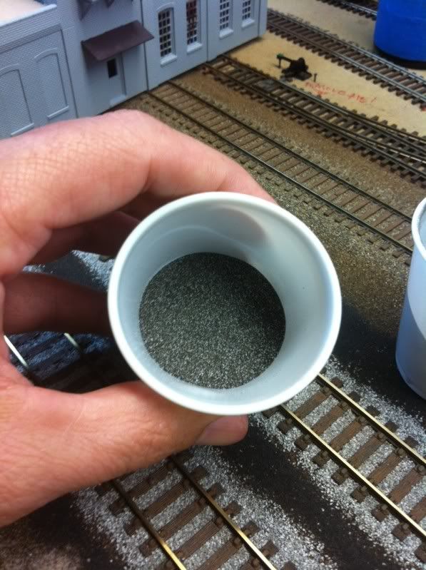

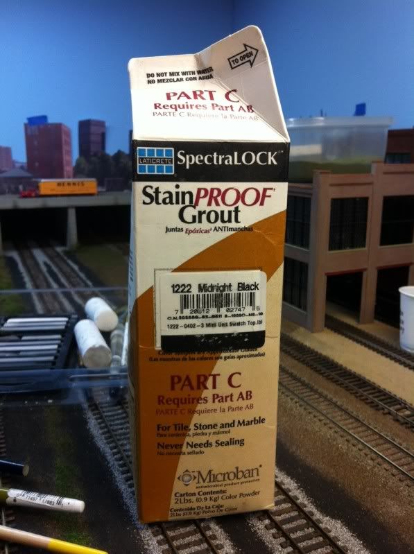

Can't remember if I ever posted one previously (and am too lazy to go back and look), so here's a shot of the grout...in this case, it's Midnight Black, which I use to model cinders in the yards and sidings:
I buy this particular brand in the tile section of the local Lowes store and use their Raven (a dark gray) color for asphalt. Application is via a small, plastic Dixie cup, which is gently shaken (not stirred) over the area to be covered. As mentioned previously, if applied in a light enough layer, the stuff is almost self leveling. Here I used the tan or buff colored version to model an aggregate roof:

The short answer is "yes", Bruce...diluted white glue makes the grout concrete-hard when it's dry. But there's a wrinkle or two that I have learned working with it. First, I use 70% isopropyl alcohol as my wetting agent; second, I apply it using a hair spray pump bottle since the resulting stream is extremely light, which doesn't disturb the grout's smooth surface. The diluted white glue (40% glue, 60% water with a couple of drops of liquid soap) is then directly dribbled onto the thoroughly soaked grout, holding the bottle tip as close as possible to the surface in order to minimize displacing or "pushing" the grout around.
It's hard to see in the above picture, but I screwed up the roof covering by applying the alcohol using an eyedropper; despite being close to the surface, every drop from the eyedropper put a crater in the grout, which wasn't noticable until after everything was dry. Fixing the boo-boo was apple pie easy: just give the roof another light coating of grout to smooth things up, then use the spray bottle instead of the eyedropper to get everything wet.

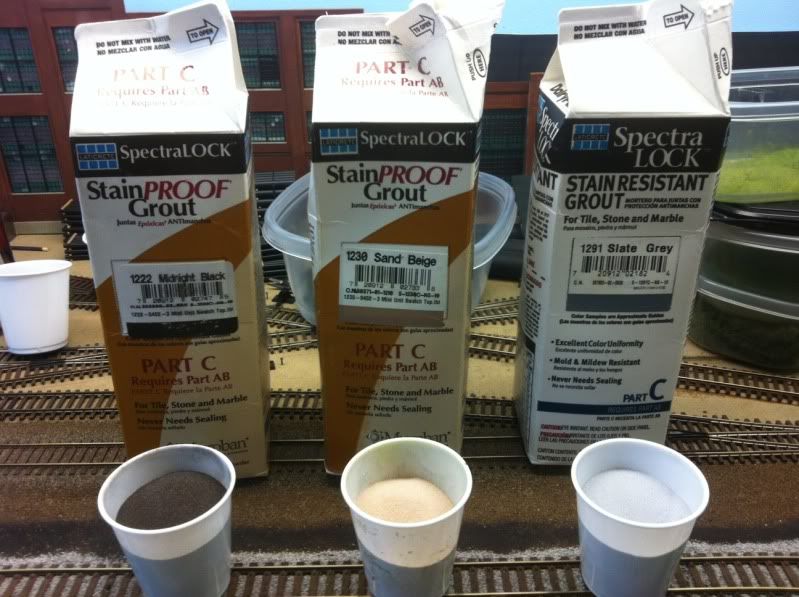

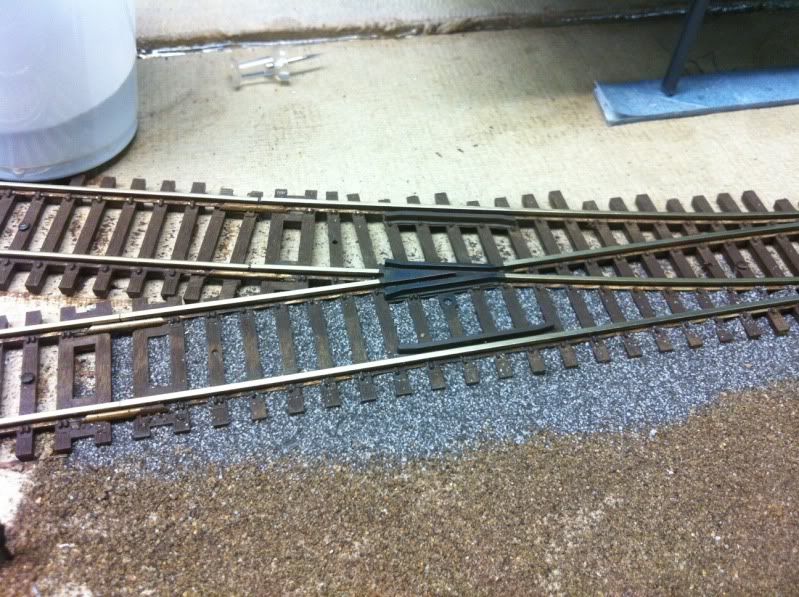

Hmmm....Midnight Black, Sand Beige, and Slate Grey...stirred, not shaken:
Granted, that may not be exactly what you're looking for, but the mix shown in the photo was roughly about 70% black and 15% each of beige and grey...personally, I think it's too light but then again, beauty is in the eye of the beholder. One other aspect you may want to ponder: the grains are very SMALL, which may or may not suit your sense of scale. On my layout, the viewer's eye is approximately 100 scale feet away from the track; what would real ballast look like from 100 real feet away?

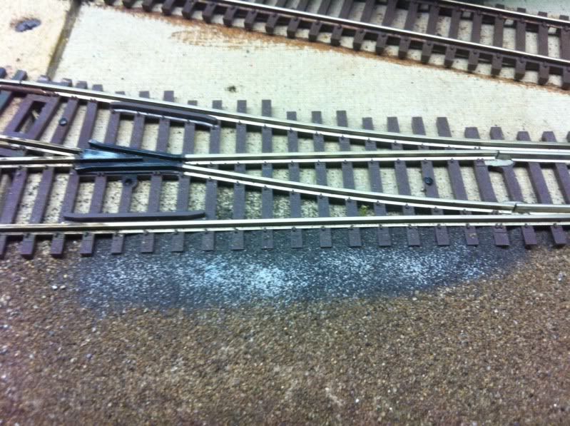

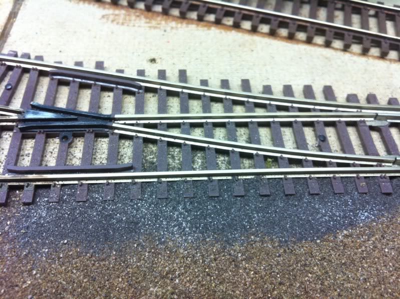

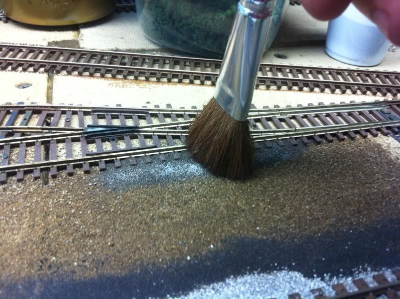

OK, expanding on the previous idea, I sprinkled a base coat of Midnight Black on, then applied a VERY LIGHT pinch of tan, followed by a VERY LIGHT pinch of gray:
Not much to look at...bear in mind everything is still dry. Notice how the grout doesn't stick annoyingly to the rails, ties, and spikes? Anyway, I took my fluffy "ballasting brush" and lightly tamped the mix:
Viola! Now it looks a little better...
Being candid, it's darn near impossible to discern any visible difference between the tan and grey grout particles due to their size...
