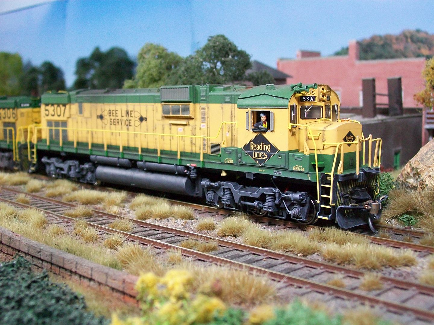

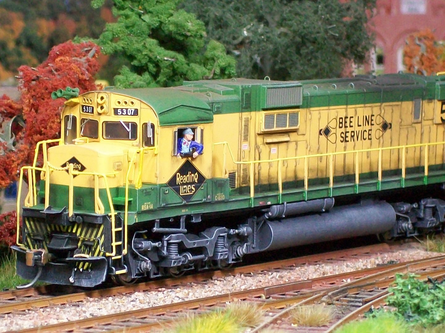

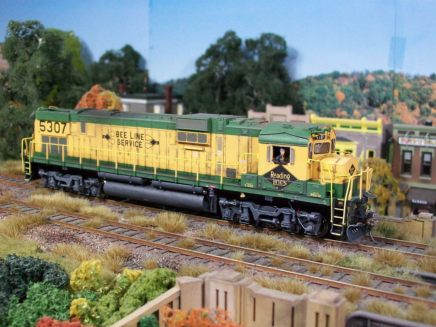

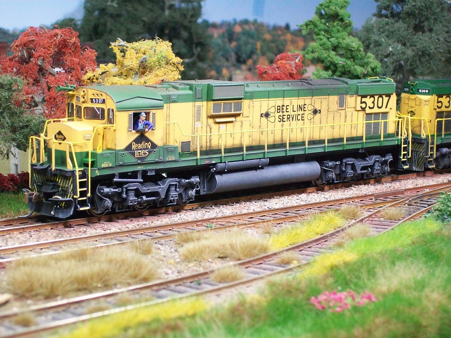

Can't wait to see the finished NYC project.I received my C630's and I thing Bowser did a great job.I renumbered one of the units,added more detail and weathered.I plan on adding more weathering affects later.Here's RDG 5307

Hi Chris. Your Bee Line Alcos are super/ The painting is very well done. I really like the dry brushing on the trucks and fuel tank.

Thanks Chris,but I can't take credit for the paint job.The unit is a Bowser factory paint.It was originally numbered 5308.I removed the no. using sol-v-set,scotch tape and eraser and then renumbered.I painted out the no.boards and added the new no.I did hand paint the trucks,fuel tank and under frame with a weathered black and used white weathering chalk to highlight.I added the crew,drop steps,speed and wheel slip recorders,arm rests and weathered with powders and pencil.The unit was sealed with dull coat .

Well the end product is way beyond out of the box. Just great Chris. Lookin forward to seeing more Alco's and more of the layout.
