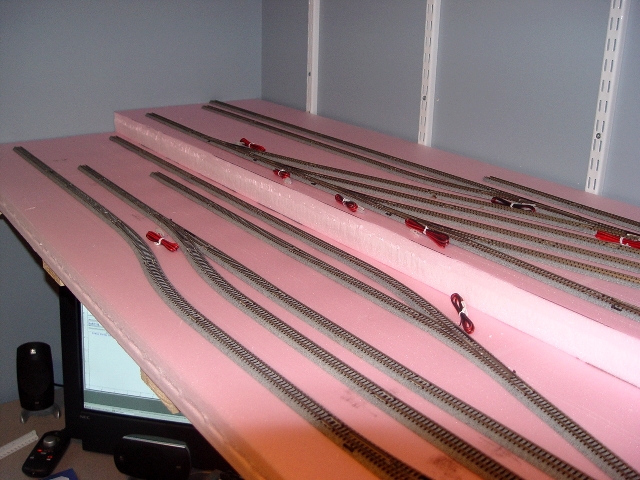

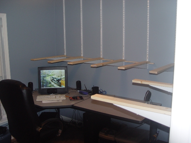

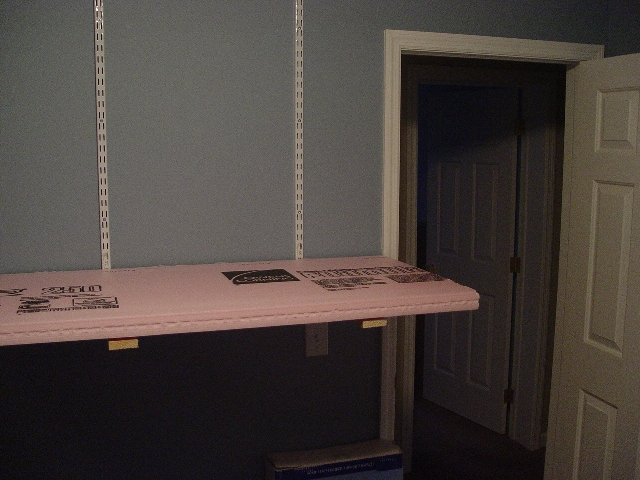

My layout is in my office/computer room since I don't have a basement :(
I might be able to extend the other end and make a "U" shaped layout. All the RR needs are the appropriate approvals (read: wife' ok).

Anton, very nice!

Anton, this looks like a real nice solutuion to the no basement. I assume it is an L shape , but can't quite make it out, if it is will you be able to get between the two different levels or are they each independent of each other? Thanks Pat

Crabster,
Looking at your photos I see you have what looks like 1 by 4s laying on their side on top of shelf brackets with your pink foam on top of this.
I use shelf brackets for my support but instead of the 1 by 4s for support, I just added a piece of 1/4 inch plywood under my foam. Just cut it to the same size as your foam.
This will save you a little in height, strengthen your layout in case you need to move it later, and will be more warp resistant.
I certainly helps to glue the "sandwich" of plywood, foam and foam together. If you glue the plywood and your lower level of foam together and just glue your upper level with a couple of dots of glue then you can easily cut out sections of your upper layer to take to the work bench for detailing scenes.

Great minds think alike because I've been thinking about doing exactly what you suggested. I'vebeen tinkering around with the trackplan again anyway (it's all Mike and Rays fault for that) so I may just do that.
