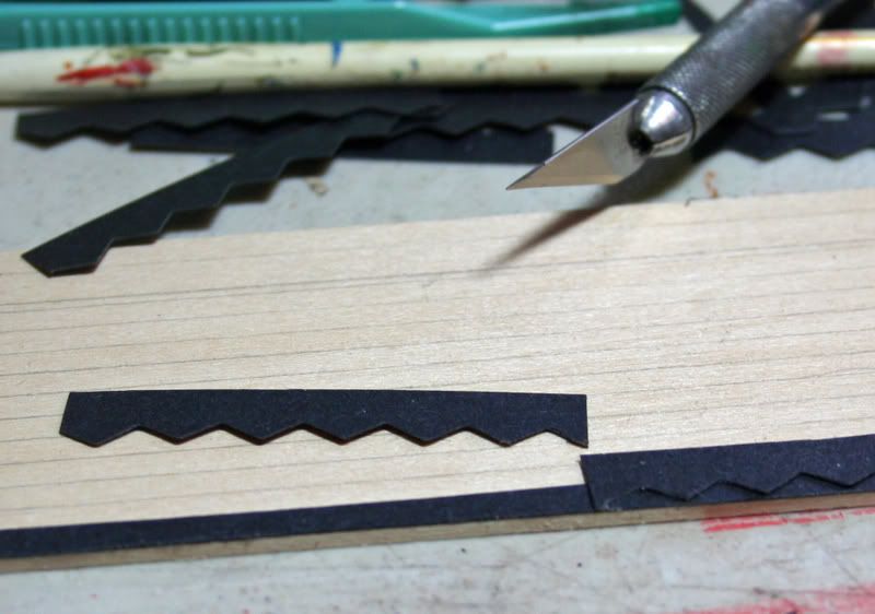

k9wrangler Posted - 05/11/2020 : 9:49:29 PM
I made some for a building some moons ago using black poster board cut with pinking scissors. Looked good. Something thinner than poster board would be better, thinner, for a tower sized building.
