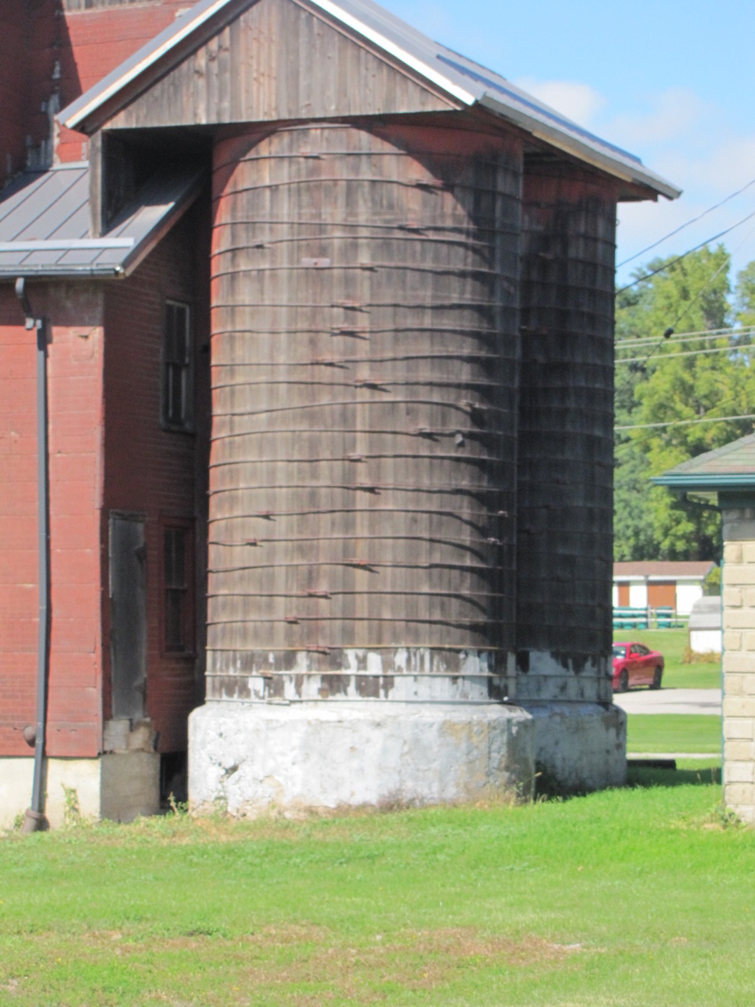

Bill Gill Posted - 10/20/2019 : 08:13:30 AM
Thanks, Bernd, that's the one.
Bernd Posted - 10/20/2019 : 08:02:19 AM
Bernd recently posted images he took of a grain dealer in Leroy, NY . Those silos also have wobbly bands. (I can't find his post)
I couldn't find it either, but I where it's located on my ISP. Here it is again. Hope it helps.

Here's a silo I banded using scale size copper wire. I twisted the ends of each band together tight enough to hold it in place. Then I snipped the twists close to the band, bent them flat against the silo and superglued them to it. That all got hidden under the elevator shaft. I also put a few tiny dots of superglue aound each band as additional insurance. Most of those were at seams between the siding, also where the turnbuckles are. It's held up well, and the silo has been moved around a lot because of work on the layout.
The bands are not smooth and parallel, but neither were the ones that inspired this model. The sketch is only slightly exaggerated. That coal facility was long gone when I went back to get photos, so the doodle is all I had.
