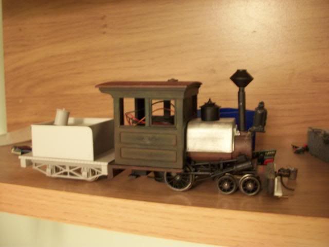

So, the backwoods miniatures tender kit came back into stock and was ordered, and arrived very promptly.
When opening the box, I found to my surprise that there was very little to it, the tender floor and end beams are one casting, as is the tender body, two side frames, a water hatch, some wheels and screws (and some half roof parts, and split bunker parts for use with their vertical boiler kit)
while this would be a very simple kit, and could probably be built in an evening, however, why make things easy :P
I need to add pickups, since I removed two of the pickups from the engines main drive wheels, I didn't want to rely on the small lead truck just for pick up.
I started out with a square of PCB board, and some brass strip, and I spent about 35 mins bending, soldering, and then stoped and thought "why am I making this harder then I need too?" so took a length of thing brass wire, put 3 small loops in it, two will rest agaist the backs of the wheels, and centre loop, allows a screw to pass through and screwed into the tender floor. with about 10mins, most of that being spent adjusting I had pick ups added :)
so have a late night blurry photo
I have also decided to rework the DCC fitting. I was going to put the chip in the tender, now I am thinking I will just cut the chip off, get a far smaller one, solder onto the leads left in place, and slide it under the saddle tank, then only 2 wires will be coming over from the tender, and I will keep the cab, the underframe erc very clear of wires :) (and saves me stripping it back down to swop the whole chip out,
